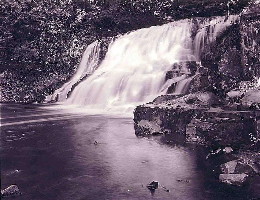

Wasdsworth Big Falls, Connectiut
8x10 Gandolfi Variant; 240mm G-Claron
7 seconds at f/64
Ilford HP5+ developed in Agfa Rodinal 1+25
Ilford FB VC in Ilford Multigrade 1+9
No filter during exposure.
Taken 2003. HP5+ rates at EI= 200. Masks: FP4+ unsharp mask (DRM=0.5), litho SCIM, litho HLM, litho Fog Mask Type 1, mylar dodge mask (pencil shading). Main exposure at 170 magenta. Edge burning at 100M and 100Y. Burning in using card w/hoe at 170Y
jbridges said:
Where is the purple tint coming from?
Not sure where the purple tint is coming from. I noticed the same thing. I guess I ought to send a little time trying to understand how my scanner works.
