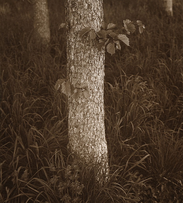

stem of a hazel
enlarging the neg.:
positive film Ilford Ortho Plus in Separol Soft 1+4 2:15min
print film Arista APHS in Separol Soft 1+4 2:40min
Kallitype on Arches Platin
more information is to be found here http://www.moersch-photochemie.de/content/artikel/anleitungen/136
extended backyard
Hasselblad 80mm
TMY & Finol
kallitype
This is a striking image to say the least. I really like how the out of focus areas leads the eye to the centre of the picture.
Hi Wolfgang, this is lovely.... it happens that i made my first kallitype last night in my humble lab...It looked great too.....I would be happy to post it next to yours but the image disappeared in the fixer?!???? I was too wounded to try again.... :smile: .... seriously ... :sad:
Miles
Wolfgang I just read your instruction on the proper use of fixer... I mistakenly used hypam fixer and poof!!!! Can't wait to head back to my lab this p.m. THanks lots...
Miles
thanks again Wolfgang. I actually have a ton of T4 alkaline fixture on the shelf so I should be good to go ...
Stunningly beautiful! The image and process mate wonderfully...
