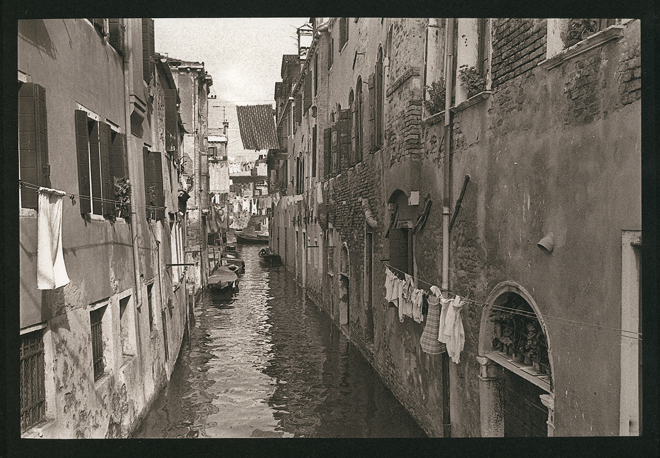

Venice Canal in Palladium
Another scan of a palladium print from a negative from the early 1980s.
Venice, Italy
Leica fff, 35 mm Summaron, Epson v850 Pro scanner. Epson Photo R3000 printer
N, R.
Tri-X 400, developer not recorded
COT 320, potassium oxalate developer
Hybrid Materials & Processing
Digital negative generated on Pictorico Premium OHP transparency film.
Photoshop curves
Doug Schwab
Especially love the laundry on the line. Great work.
Beauifull ! Your original is a 35 mm negative, enlarged to ? 8x10? This was then contact printed on hand-coated palladium paper.
The software used allows you to produce a digital negative that has the contrast range required to match your Pd-paper method ?
@Peter Rockstroh01 - Yes and yes and yes! Since inkjet technology has so vastly improved, it is possible to make negatives to size with a Photoshop Curve. Curves can be designed for any process. I even made one for gelatin silver contact printing. This enables one to start with a digital file, or as i frequently do, it allows me to correct problems in existing negatives, up to a point. Right now I'm looking at an 8 x 10 negative I made a few years back. I shot two films of the same subject, one wide open and one stopped down all the way. I guess I miscalculated reciprocity compensation, so the stopped down negative is too thin for palladium printing. Also, and much more troublesome, I scratched the negative during tray processing. (Something I hate to admit.) So I'll to scan it, fix the scratch in Photoshop, and then hopefully produce a negative that will work with palladium. I use Mark Nelson's Precision Digital Negative system, PDN to generate the curve. I have spent lots of time and money on this, but, hey . . . And I appreciate your compliment.
