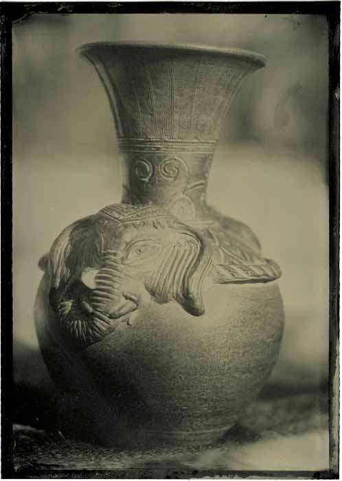

i shot this in direct sun. for some reason i thought it was better NOT to shoot in direct sun......i do not know why i though that. it came out fine IMO. i will do more soon.
i shot some glass negs also. after i print them i will scan the print and post it.
5x7 aluminum
rosendale ny
century universal 8x10 with 5x7 reducing back. 12 inch TR f7
1 sec @f7
collodion. sugar developer. KCN fix

I very much like this image. At the rate you are going, you will have a show in no time! The direct sun has created a beautiful sense of light captured perfectly in your study.

Another nice one Eddie. You are progressing at an amazing clip!! Keep up the good work.

Eddie very nice work--while you continue with this I will be putting your old roll film back to work--arrived today--Thanks again

What a beautiful image. The processing has truly enhanced a very simple subject. A real gem. Thanks
