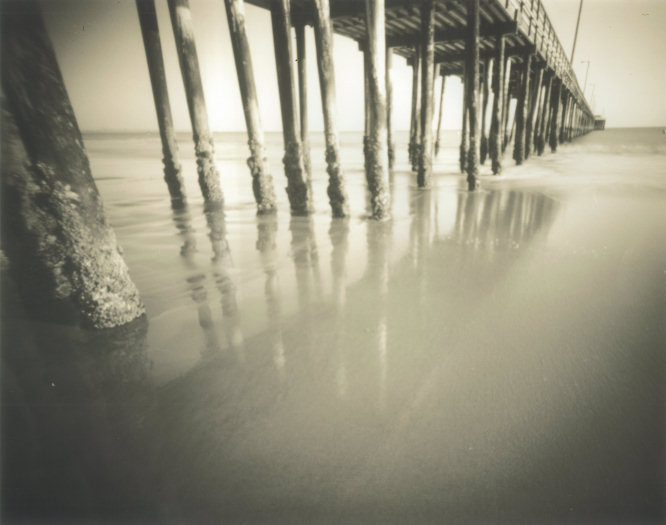

Reviving an old negative to try out Andrew Moxom's technique of partial bleaching followed by sepia and selenium. Just getting used to the signs of strength of chemicals as it pertains to tonal density of the image. Thanks Andrew for this great idea!
I threw this in the technical gallery because I need feedback on tone. Is it just enough? Too much?
Avila Beach, California
Pinhole, 4x5
Bergger - Rodinal
Ilford MG FB Matte, Dektol, Sepia/Selenium Split Tone
@djkloss: the sepia is Kodak Sepia II kit. The bleach is diluted. I tried first suggestion by Andrew Moxom to dilute the bleach stock to 1:6, but I like it less dilute. I'm working now with 1:3 dilutions and getting these results at 30 seconds to 1.5 minutes depending on dmax and tone of print before beginning the bleach process. The selenium I used on this was Moersh Selenium but I think I have seen similar results with Kodak Rapid Selenium, so I don't think that matters so much the brand when doing split toning like this! Hope that gives you what you're looking for.
