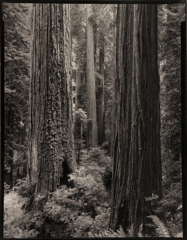

Two Redwoods: Prairie Creek Redwoods State Park
Cal Barrel Road, Prairie Creek Redwoods State Park. Along side the dirt road as my three 4-yr-old boys ate their lunch next to me on a blanket..
Homemade (not me) 11x14 camera, G-Clarion 355mm, Ries A100 Tripod w/ 250 head
F64 at ten seconds. Direct sun hitting the left tree and elsewhere, measured a 5 stop range of light, but probably closer to 7..
Ilford FP4+ in pyro, my notes say, 40-80-2000 for 10 minutes @ 70F, but not what kind of pyro
Monochromatic Single-transfer Carbon Print. Developed in hot water (120F)
none
Thanks -- and that black burnt-out bit on the redwood on the left has a little detail and lots of texture in it (due to the raised relief of the print).
A majestic tree taken in majestic format. Very deserving ! The print is beautiful and deserves a special wall for display. You know the next phrase : __________________, Bogota, Colombia. No seriously, this is what photography is all about. I am glad to see the work of people who care and know to keep the craft at its best alive.
Absolutely lush and beautiful. If it were on my wall i would be staring at it and studying it constantly. Never seen a carbon print, but even in apug squished facsimile it is amazing. That detail is so captivating and doesn't end....
This is so beautiful Vaughn, I can't stop looking at it. The incredible details and the light - I feel like I could be transported by walking through the gap in those trees.
Magnificent. A lot of work and a lot of experience obviously came together for this. I love the depth in the middle of the print, the other trees echoing the foreground.
Thank you. Luck favors the prepared.
