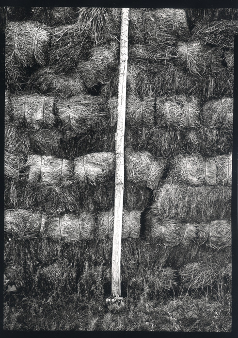

truss of straw - France
payral
5x7" contact print on Lodima #2 - Amidol 1 mn
France
Canham 5x7"
TXP - ABC Pyro
Lodima #2 - Amidol
very nice printing ... appears you are coming to terms with lodima ...
Excellent I think! I still can't get a decent Lodima print from my negs but it's good to see people having great success with the Lodima
I like the tones of the new paper. I'm not surprised to hear problems getting old negs to print. I've done step wedge test and printed a lot of different DR negs to see what the PAPER wants instead of trying to push my favorite neg into it. The negatives that I would consider a condenser enlarger neg printed so good I am setting back and rethinking my attitude of pounding on the neg so much. I pulled out a couple of old negs that were just to flat to my mind and they printed a lot better than I thought they would. Just finished doing test on acros and Fp-4 and found this paper likes less DR. If I could only have one grade I would take the present grade. I like the shot. Very good test of the paper.
