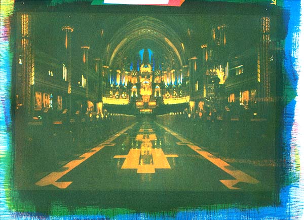

Tricolor gum printed from separation negatives made in PhotoShop - taken from a scan of a 35mm slide.
Three 4 minute exposures using cadmium yellow, alizarin crimson and phthalo blue.
Montreal, QC
Nikon N90s
Long
Velvia
Lenox 100, pre-shrunk
Very cool colors, a modern visual experience via a 19th century process.
How did you get the 3 coatings to 'sync up' - for lack of the right term?
Sorry so slow to repond. I use straight pins and drafting tape for registration. Just poke the pins through two corners of the negs and the paper.
