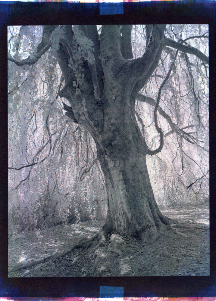

Eight layers of gum over cyanotype
Riverview, Coquitlam
RB67
Rollei; Xtol-R
Hahnemuhle PR; Water
720
Hi @awty. Yes, each layer is processed. I usually leave the print in the clearing bath after each layer has been exposed, for thirty minutes to an hour, depending on how much pigment I want to come off. Some areas are spot brushed lightly to allow previous colour layer to show through. Cyanotype layer always goes down first. If more blue is needed, then I'll lay a blue gum layer down.
