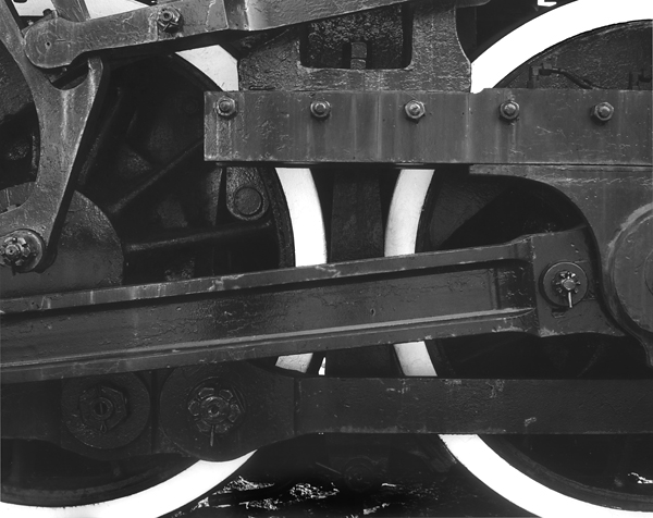

This is a reprinted version of the last train shot I uploaded. i have reprinted it on Grade 2 Azo. Would love to know what people prefer or any thoughts you might have. thanks. doc
Greenville, PA
Korona View 8x10 12" Wollensak Lens
7 seconds @ f45
Tri-X, Pyrocat HD 2:2:100
Grade 2 Azo, MS Amidol
none
thanks guys. i prefer this one as well. i had much help from skillian on this and the rail and shadow photograph.
plan to burn down, or possibly scrape the highlights at the bottom center off of the emulsion as i find them a bit distracting.
I vote for this one on the shadow detail
Lovely composition. Detail in the neg and print must be marvellous.
Phill
Absolutely gorgeous.
Definitely Freud-like! Symetry, tone, POWER!
I love it.
Thanks everybody!!!
this is my first 8x10 neg and print that i consider a success. once you start, i can see there is no going back. i ALWAYS appreciate your thoughts and views GOOD or BAD. doc
What led you to 2/2/100 here.Our little group is just now wrestling with pyrcatHD glycol and having some difficulty getting the right ratio to get the best neg.... either a note on email or here would be greatly appreciated.... thanks.... Logan.... oh, and I really like this print... suspect this neg would class as a 'good' neg to our gang here in Western NC
