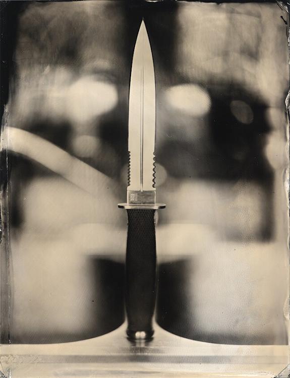

Testing some freshly made collodion and a new lighting rig using small aluminum shop lamps and flourescent daylight balanced tubes... As for the knife, well that is something I've had for many years as a collector piece. I'm also using the new 'Schwab' plate holder and whole plate insert. So far so good.
Home studio
Kodak 2D and Darlot Petzval F4
30 seconds @ F4
collodion on whole plate aluminum
Andrew that's a very rich and nicely toned image. I'd be very interested to hear about your lighting setup; sounds inexpensive!? Have you discussed it anywhere on forums? Thanks.
Wow, the metal knife looks so awesome with this media. I bet it's really over the top looking at the real deal.
Speaking of the shop light with flourescent bulbs idea, I tried that some time back with some pretty damn good results. It pleases me to read someone I respect has given a go at it too and not ashamed to mention it! :smile:
The lighting set up is REALLY primitive. Basically two aluminum spun shop lamps with the built in clamps, and flourescent bulbs balanced for daylight 5000kelvin. I clamp them either side of the main rail on my Kodak 2D... and voila... light :smile: There's enough light for still life work, but portraits might be a problem with 30 seconds exposure not using a headbrace... I still have to try it out for portraits though. I think I may get some good results depending on how good the sitter is.

I can see how you get that sense from it. As for me, it evokes a little different effect. I'm sure you've heard of the term "lens porn" before. Well, this is knife porn! :D
It is three dimasional even more than usual, it positively pops out, which must be alot to do with you lighting set up too. Excellent, Andrew. K
