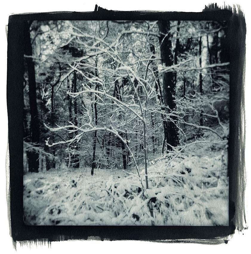

toned Kallitype
Wolfgang Moersch
toned Kallitype
This Kallitype was too dark (about 30% overexposed)
steps to rescue
1. bleached 1+100 1 min and fixed again to reduce density, the print was still too dark and soft
2. bleached again 1+50 1 min and toned with thiourea (MT3 with a just small amount of alkali - 50+15+1000ml) to lighten the highlights and upper midtones
3. MT7 Iron Blue 5+5+5+15+5+1000ml 90 secs - resulting hue yellow and green
4. weak solution of ammonia to achieve a cooler tone
Holga 120N
Delta 400 in Tanol
Parchment, sodium citrate

It would have been interesting to see what the Kallitype looked like before you saved it...
Thanks for sharing your thoughts on this one, Wolfgang...
What size is this print? Is it a contact print from the original neg or have you enlarged it?
