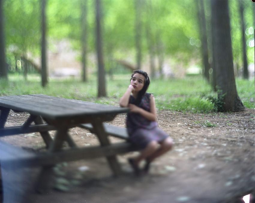

I want to share with you my first "tilted" photograph ...
Home, Spain
Graflex Pacemaker Speed Graphic + Aero Ektar 178/2.5
Fuji 160NS - home dev
I think its a good technique but I think here it's just style over substance really. But as a test it's fine.
grahamp said:
It is a finicky thing to get right, and practice it the only solution. This setup would likely have worked as a swing to put the focus plane on the bench seat, too. Your children are remarkably patient and tolerant!
Which is another tricky thing, deciding what gets focus and what you want to blur and how much. Yes very nice looking and patient children.
Interesting! I would have brought the sharp area a little closer. I'd like to see the ground behind her out of focus and her whole body in focus. Just IMHO>
I enjoy this image. Gives me a sense of how we are not able to read into others thoughts. Keep working your style.
I'm sorry ... a bit late.Thank you for your comments. As I said, I just want to know a bit more about the effects I could achive with the tilt movement of the front standard. I focus the eyes but I really thought that the focus plane would be "broader". I love the effect ... I'll try better next time.I'm having some focusing issues right know. I don't know what is the real reason ... Thanks a lot. Regards
