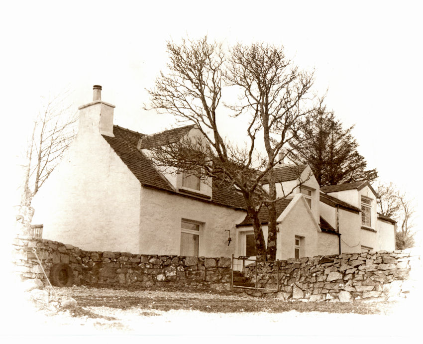

Our holiday cottage on Skye and my first attempt at Lith
Broadford, Skye
Mamiya 645
Ilford Delta 400, DDX
Slavich Unibrom Moersch Easylith. Selenium Toned.

Well done with the Unibrom. I am having trouble taming it.
Whether it was beginners luck, I don't know, but I pulled two prints straight off. This was the slightly less developed of the two and the better one. Exposure was as measured by my analyser pro + 2 stops. Easylith was 1:25. I wasn't timing but image came up quite quickly - guess 3-4 minutes max in slightly warmed developer - 25ish deg.
That's more or less what I'm doing. I use an analyser pro as well. I find that the first print or two is not so bad, but then they deteriorate rapidly and go peppery. I think I need to add Sulphite to the mix at this point...
