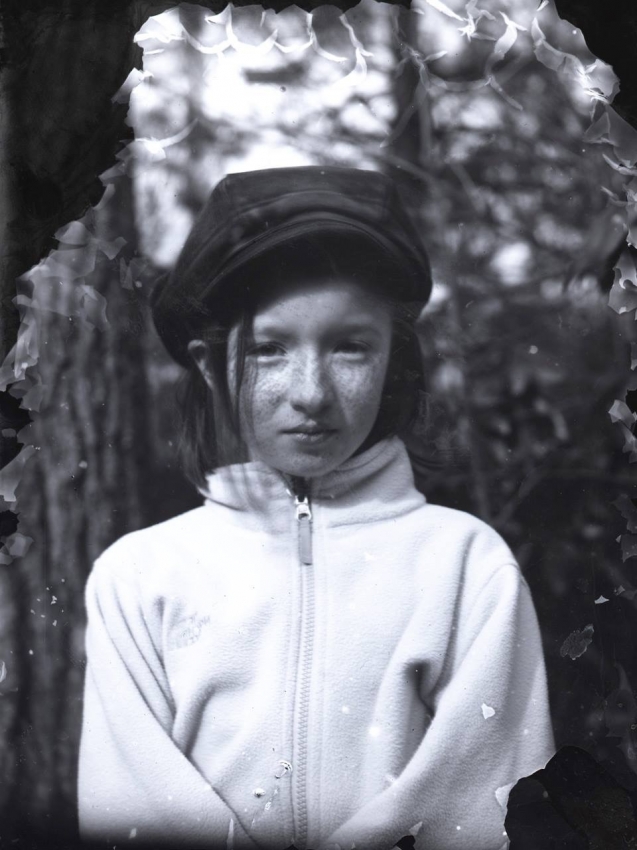

Hand-coated 5x7 dry plate negative photography. Mixed my own emulsion.
Brookline NH
Seneca No. 9
4s
1890s era emulsion, ISO 1
Nodda, nice portrait of a lovely subject, but I must admit - your prior work makes me want a more than casual look at anything you post. As I looked, the questions came faster than I could remember them all. The least puzzling (maybe shouldn't be) is the crackled edge treatment. 1890s era emulsion - reproduced? Resurrected after actually being mixed/made that long ago? ISO derived from testing? How in this particular universe can a subject of any age hold that still for 4 sec? I have no doubt this image will be treasured as long as she or anyone who knows her is alive. Its really good, but seems otherworldly unique.
Thank you. Let me try to answer your questions: The crackling is because the emulsion lifted off the glass during development. I thought I had the glass cleaning step down but apparently not. Complex processes can be humbling.
I mixed this batch in November 2015. It is same emulsion that all my previous dry plate images are from, except I divided the batch amongst several light-tight containers to avoid excessive cycles of reheating and refrigeration. This plate is from a container that has only been reheated once. The recipe is from unblinkingeye.com
ISO 1 is a rough estimate based on use. So at the very least this is what I expose it at. I develop under a safe light and watch the image form. The contrast in the images seems reasonable so it's probably close. I haven't formally tested tho. Would much rather "wing it".
When queried, the subject indicated she "stares off into space and doesn't think of anything". :smile:

"Complex processes can be humbling." you are incredibly gracious. Humbling indeed. At my skill level, its all humbling - on a regular basis.
The crackling may be accidental, but looks very handsome. Your lovely subject - even not thinking - is almost super-human in her stillness. I've never seen that done before.
