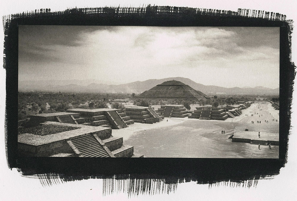

4"x8" palladium print from digitally enlarged negative. Original is 6x12cm from Lomo Belair X/6-12 on FP4+.
Teotihuacan, Mexico
Lomo Belair X/6-12, Zenit Belairgon 90mm f/8
1/125th @ f/16
Ilford FP4+, Pyrocat HD 1:1:100
Bergger COT320, Potassium Oxalate @ 130 F
Hybrid Materials & Processing
scan of original negative, enlarged to 4" x 8" on Pictorico OHP.
adjustments to contrast, some burning in of the sky.

@Colin Corneau This was not only a test of digital negative making (there's some banding you can see that is in part from paper texture being picked up by my scanner and in part because the digital negative was the first print I'd made on my printer in ages and the heads weren't completely clean yet), but also of my sous vide machine for heating my developer chemistry. It's an excellent technique (the sous vide thing) because it keeps the chemistry at a constant temperature and it also helps humidify my printing room too.
