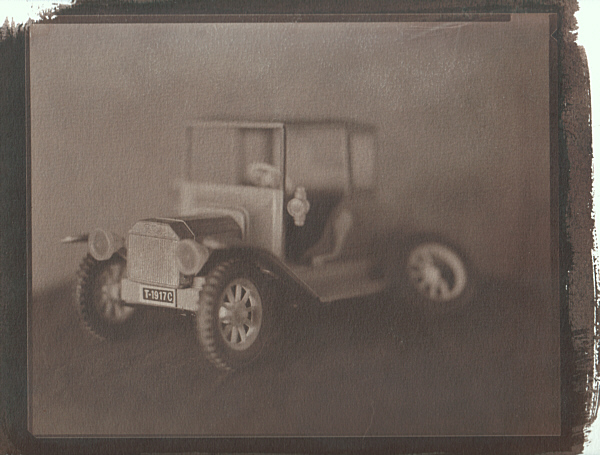

t model
t model
an attempt at VDB printing
i have virtually no point of reference, what do you think?
is the contrast ok for VDB? if not how do i adjust?
should the paper be sized?
Tenambit, NSW, Australia
Deardorf 8x10
1/8th @ f6.3
Fortepan 200 @ 50 in HC110/B 8min
Canson Montvale & VDB, rinse and weak Ilford rapid fix
hi ray
I really like the image. the dmax can be alot more with VDB. Rapid fix is too acidic for VDB's (it can eat the image right off the paper), I mix up my own sodium thiosulphate. Also, VDB's really require 2 coats of sensitizer to get good dmax. Paper doesn't need sizing. I also use a platinum or gold toner before fixing, for archivability but also further dmax. Check out Wynn White's VDB article at Unblinkingeye.com for good info.
cheers
david
Hi Ray,
The density range (DR) of your negative is not adequate for Vandyke. You have to develop for > log 2.0 DR. Unfortunately Vandyke doesn't have any contrast control system so you won't be able to print your negatives with low DR.
Nice first try BTW...
