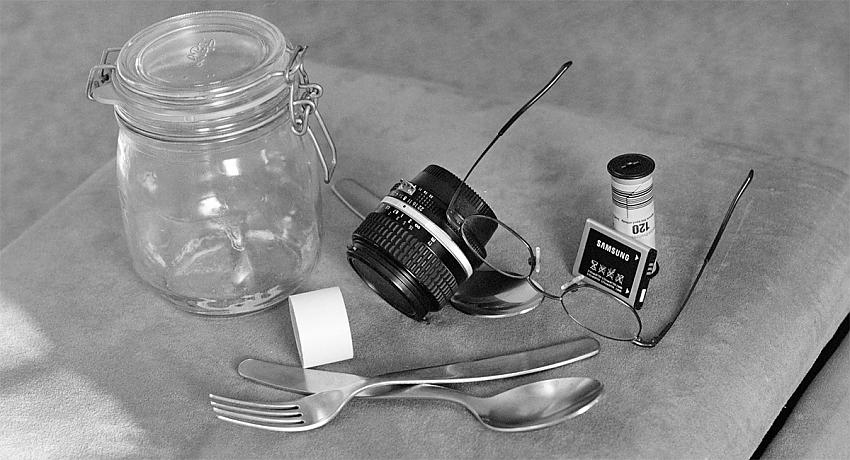

Testing Tri-X @ ev 400 in Diafine.
I'm very much attracted to this combination; Tri-x with its timeless 'classic' grain structure, and Diafine with its forgiving, easy-going nature.
The series of tests, in which this is the first image, was inspired by an article by Steven Schaub on FigitalRevolution.
http://figitalrevolution.com/2008/03/22/diafine-developer-and-txpart-15/
@home
Hasselblad 501cm, Zeiss Makro-Planar 120mm/f4
as metered; Seikonic L-398M
Tri-x & Diafine (3min A/B, water stop, 2 x 5-min fix)

I sort of like it, but I find the grain a little too pronounced. I'm going to test Tri-X with D76 stock, Xtol and possibly Microdol-X just to compare.
Btw.. this is not a print. Its a straight-scan of the negative, without any modifications other then basic levels + a simple contrast curve.
