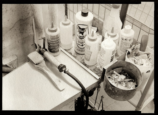

This was left in the developer too long (still learning this DBI thing) and is a little white, but just curious what others think.
5x7 contact print.
Daisy Cleaners, Corinth, TX
180mm f/5.6 Fuji
1 min 12 sec
J&C400 Pyrocat 2:2:100
Palladium solution on Stonehenge Rising
Jeremy, I love to see a full range of tones in palladium prints. They don't need to be soft to be nice. I really like the look of this one
Good job Jeremy, IMO this is a perfect tonality, I think you got the IR DBI nailed buddy...
Melisa. DBI= development by inspection. You turn a green light on and look how far the negative has developed. In Jeremy's case he is using an Infra Red viewer to inspect the negative instead of a green light. If you visit Michael A Smith's site, there is a good article on DBI.
Nicely done Jeremy!
Melisa, here is a direct link to the thread Jorge is referring to.
http://www.michaelandpaula.com/mp/AzoForum/one.asp?ID=6011&PgNo=&GID=6011&CID=2
I love images of tools of the trade and you've captured it so well. This is very pleasing to the eye. Very easy to look at.
