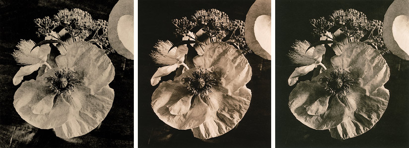

son´s daily gifts - a comparsion
Wolfgang Moersch
MCC - PW17 - Fotospeed
SE5 Master Lith 1+15 (MCC) 1+35 (PW and Fotospeed)
Living room
Hasselblad 500C
HP5+ in Tanol
MCc, PW17, Fotospeed & SE5 Lith
They all have their good points. The MCC (old Agfa?) looks best in the shadows, the PWT in the the highlights and ...come to think of it, the Fotospeed isn't doing anything for me here.
Thanks again for the demos.
Yes it is the Agfa MCC - the last batch. This paper has been changed again from time to time. Sometimes, it worked in the past, sometimes not. It was the first I tried next to Sterling Lith.
Also the resurrected MCC of Adox is not easy-care, but it works with patient urging.
Example http://www.apug.org/gallery/data/2/Efeustamm-MCC_Lith.jpg
