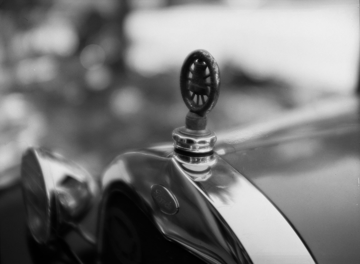

Take the rear group off and put the front in the rear inside the camera and it is a formidable 11" f5.6 soft focus lens. I used the Betax shutter for the exposure. I was at 14" f10 because of long bellows draw.
tonopah nv
Kodak 2D 8X10 with 6.5X8.5 reducing back / Wolly 15" f5.6 tele / Betax shutter / $48 bucks for excellent soft focus with a shutter.
1/10th
Aviphot 200 rated at 80 / PcatHD
film scan
adjusted levels and spotted
