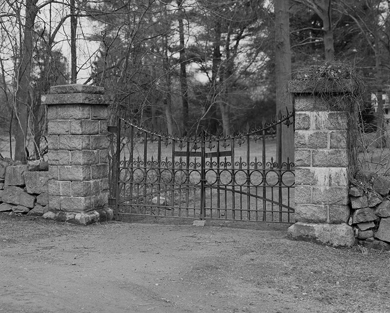

I went to test my new to me RZ ProII AE View Finder. Loaded a roll of film (thinking it's HP+5) shoot the roll, then develop. At no time did I double check the film used. So I developed in D76 1+1 for 11:30 minutes. Taking my first look at the negatives, I was shocked to see PanF shot at 400! Duhhhh
Glenn Magna Farm Danvers, MA USA
Mamiya RZ67 with AE View Finder set on average, 110mm lens
f.5.6 @ 125 sec
Ilford PanF Kodak D76 Developed thinking it's HP+5!!!
none
I am both amazed and impressed!
Nice pic, too.
Nice photo, good contrast.
You should push film more often.
Would only be a problem if you had strong high lights, which would of been blown out, because the tones were more even you just got a bit more contrast than you would of before.
Actually, FOUR stops under, according to me. Low contrast scenes allow for this if you overdevelop. - David Lyga
There was nothing there in the scene that was really capable of being blown out. The contrast range was amenable towards exploiting this 'safety factor'. - David Lyga
Great photo but you must be wrong about it being PanF. Isn't this the contrasty, temperamental film that is like nitro-glycerin. You look at it sideways and it blows up in your face:D
@pentaxuser That's only when you use it on a sunny day, and shoot it at film speed, and then develop it correctly. Other wise you end up with what I have, PanF @ 400 D76 1+1 for 11:30 min. :smile:
I'm interested to see what a print will look like. Maybe tomorrow.
