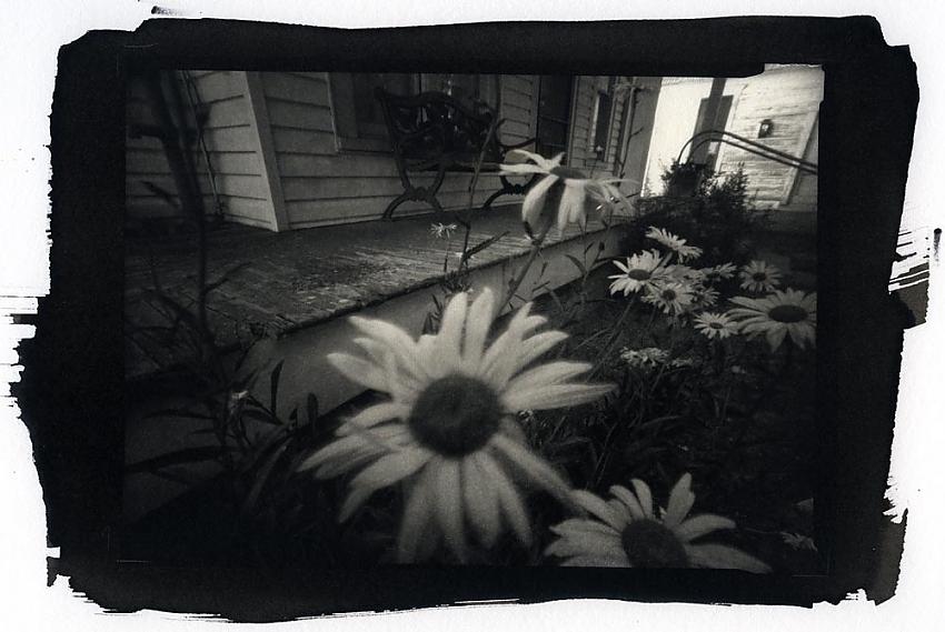

Pt/Pd print from a 5x7 pinhole neg ..... i posted neg scans of these some time ago -- thought it'd be interesting to share how the prints eventually turned out
Fossil, Oregon
cigar box pinhole camera w/5x7 back (about f/250)
4.5 min.
tx and d76
fabrico artistico bw and pot.ox.
I'm really blown away by these - real artistry and well crafted photographs. I think it's easy to do passable pinhole images...very very difficult to do superior ones. You did a superior series here.
I really like the whimsical feel of this picture. It's like a dream.
