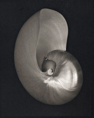

Again taken several years ago I have printed another shot of this I liked but wanted to try PT/Pd with this one. Again this is my March POM print.
garage
4x5 Ebony
long
Tri-x
Cot-320 presoaked in Ox. Acid
none
Jim,
it's funny how you say that. If you look at my past prints one of the first ones I posted is the brother to this one. It was done in slit grade using bromide paper. the highlights could not be brought down to where the Pt/Pd print has them. You can see the latitude of Pt/Pd printing over Bromide when you look at both.

This is a beautiful match of neg and process Michael. The black is so dense it's pulling me into the monitor :smile: and the highlight detail is gorgeous.
Nothing I've run across can begin to match the range of Pt/Pd although I hear azo may come close..?
I use both Azo and Pt/Pd and I can say that Pt/Pd has a longer tonal range, but Azo is in a class of it's own when it comes to standard B&W papers.
