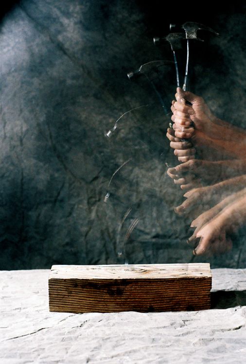

I had an idea last weekend about using my Dad's "bug" style telegraph key to fire rapid sequential strobe shots. A bug telegraph key is capable of mechanically repeating evenly space "dits" using a balanced weighted swing arm which can be adjusted for number as well as speed of repeats. I have two fairly powerful battery powered flashes that when dialed down to 1/8th to 1/16th can rapidly repeat flash firings up to 16 times. I wired up the strobes to the key and gave it a shot. As you can see the concept works well enough. But the strobe placement needs more thought to get the best images. I set up the frame and pre-focused the camera and set f-stop and shutter speed and put on a long shutter release. With all the lights out I set the shutter in bulb and locked it open. I held the hammer in the high position and started it down as I triggered the flashes. Then I released the bulb lock on the shutter.
Tucson, Az.
Minolta X-700 w/50 mm lens
f-5.6@ about 4 seconds
Kodak asa 400 print film
scanned from negative
none

1/16 is the highest speed you can get? Seems it can't freeze the hand. I like your concept, hope to see more results of your experiment.
Alex W.
I've played with one of the commercial stroboscopes. The one I used was speed adjustable as well but it put out a tiny amount of light per shot. I'm thinking I have to lower the strobes to shoot them more horizontally across the subject and have the back drop as far behind as I can. This was shot in my carport.
The "speed" of the shot was "bulb" for about 4-5 seconds in a totally dark room. The 1/16th number is the fraction of total power of each strobe per shot. These two strobes are the only ones I have that will fire rapid repeats without recharge delay. But they can only do it at less than the total output. 1/8th power gives me 8 firings of the strobe and so on.
I think 1/16 means the strobe fires for a 1/16 of its usual time, not a 1/16 intensity - either way it works out as a 1/16 of the normal exposure - but much much faster than 1/16 sec and in fact the shortest the strobe can fire... Looks to me like its freezing the hand, the double exposure of the bounce back in the lower 'freeze'('s) does look a bit like motion blur though..
oh yeh... and >> cool!
I just looked at one of the strobes. It lists the fractions as a power ratio and in fact when both are set at a 16th my meter read f-5.6 and when both were set at 1/8th the meter read f-8.
The "blur" at the top and bottom hand position are from single pops of the strobes before and after I triggered the repeater. After looking at this for a while I think I have figured out how to do this effect correctly.
