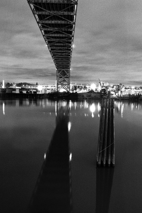

Familiar Fremont bridge
Dil. 'H' seemed low contrast (no doubt my fault)
Drooled over some stand dev. shots & found a recipe for HC-110 at 1:150. Pleased w/ results so far.

FE2, AF 28-70 3.5
spaced
HP5/HC-110 1+150, 15 sec initial agit, one inversion @ 20min, total time 55min.

Familiar bridge is still nice to see more of, nice photo again HiHo. I am not sure i like as much grain as you obtained here as macfred does. Seems some days i am into the grain and some i am not. Is it from the semi-stand development? I can't read contrast competently well yet on a qualitative level in a negative. Obviously there is some of the range that gets taken up in shadow, essential to this photo, and at night it might be right overall. It certainly looks pleasing. So judging the negative of a night shot might not be the best. Maybe if you took St. John's bridge again and developed the same way and compared. Was the contrast meant to be increased or tamed by the semi-stand? Break - i just went back to macfred's Industrial - I photo, taken on 35mm. the grain in the sky is makes it look like there is actually sky there, enhancing the bright backgound. I do like the way it came out. Still, i like what you have here, and think there was enough gradation in the clouds to make this a very moody picture.
The object for the semi-stand was a bit more contrast, acutance(sp) & tonality. Stand isn't known for contrast, usually, but it seems stronger in most negs. 'Posting another from the roll for a perspective on a a day shot. 'Completely unenhanced.

To Devorobin, can you rattle off a short descriptive how to choose when semi-stand is more appropriate in a development decision? i develop sheet film so i can make those decisions for each image. I have signed on to the new 4x4x5 developing tank recently posted about in apug, so i might now have some options.
Devorobin, Thank you. Being that this is my first go at semi-stand, I'm also interested in what methods are preferred for what effects. Probably the most wild claim I ran across is that it breaks the need to shoot all of a single roll at a single ISO. I suspect result vary, but that's still revolutionary. Most stuff is written about Rodinol (R09 one shot), so I specifically looked for stuff on HC-110. The thing that pushed me to try was a shot here by the honorable Greg Heath done in Rodinol. http://www.apug.org/gallery1/showimage.php?i=73749&catid=member&imageuser=27337 The way the metal renders winds my crank in a big way.
