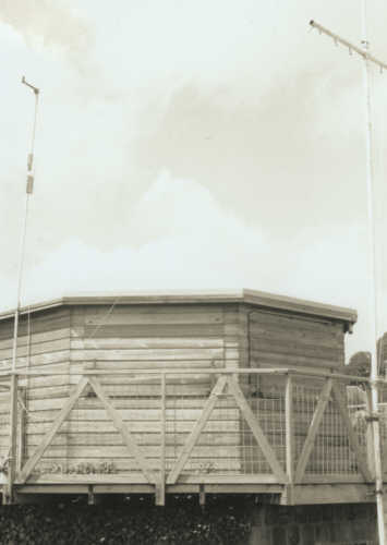

Selenium toning examples - Bleach and tone, using dilute bleach
Following the thread on Ilford Multigrade and selenium toning, this is one of a series of photos demonstrating mild bleaching, and bleach redevelopment prior to toning.
As for the straight print, but then bleaching in dilute ferri bleach (1+39), with added NaCl. Bleached for 60 seconds to demonstrate how quickly the highlights start disappearing. Then selenium toned, as for the straight toned print.
Pentewan, Cornwall
Bronica ETRS, 50mm
Delta 3200, DD-X
Ilford Multigrade, Ilford Multigrade
yellow
