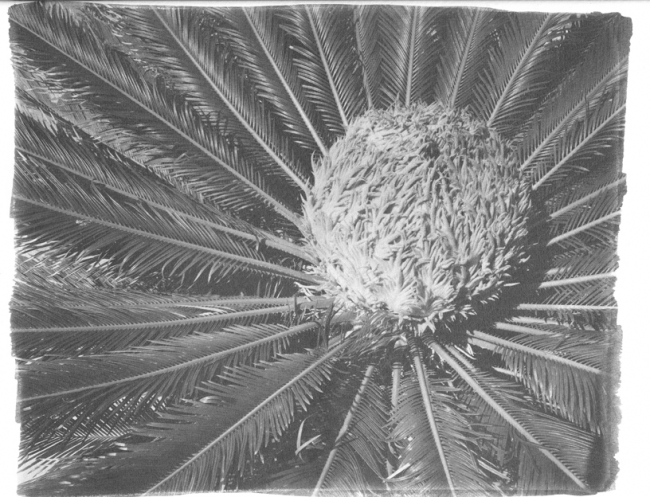

This palm, whic sits in my entry way, began to bloom in early summer. The bloom will give way to the next layer of fronds. My scanner crops the top 1/2 inch off top and bottom. The 8-1/2 x 11 image floats on an 11x14 sheet.
Manhattan Beach, CA
Eastman No1 View 11x14, 210 Angulon,
2 sec. @ f 64
Efke PL100, HC110 (b)
Fabriano Uno; Pt:Pd::7:8; double coat; AmOxalate
12
The good news it that it wasn't much of a lug to the front yard. Zabriske Pt. was another matter.
As usual the scan doesn't do the print justice, and the contrast is better on the original.
I just got my shipment of Potassium oxalate today. This should boost contrast, especially with the little jar of potassium dichromate that came along with it.
Question: What is the concentration of KOx? I got the powder, not the solution.
