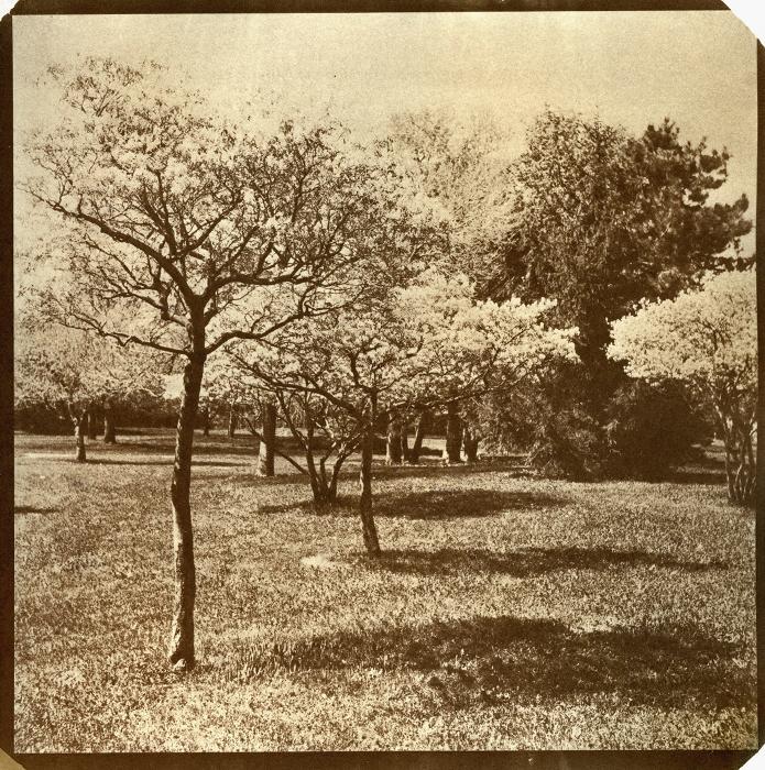

Seeing what salted paper prints from some old slides looks like. Not quite the same as an original negative, but brings a pleasant interpretation, I think.
Internegative on Kodak 2430 dupe film developed as gently as I could.
Leslie & Lawrence
some TLR
Kodak EPL, then 2430 in gainer's vitC+metol
'3/4' B&S Salted Crane's Cover in Gallic Acid
I was at the Met recently, looking at some Fox-Talbot's. This captures the mood in those. Beautiful print. And the cut corners are another Fox-Talbot reminder.
I just read this: "Internegative on Kodak 2430 dupe film developed as gently as I could." Wouldn't that give you another positive?

Thanks VERY much!
I guess it would if I processed for reversal, but I just made a projection enlargement from the positive slide, so it was ready for contact printing with just the single intermediate. BTW, many of my salt prints were contact prints from this same roll of aerographic film, shot in-camera.
Aerographic film. I haven't heard that expression in decades. Some of those films were quite large. I've seen B&W roll films that were at least 8 inches wide, back in the 60s. I assume you're speaking of something smaller? Was it a Kodak film? Excuse me for being so inquisitive. I used to work in the aerospace industry, and I'm fascinated by the technical as much as the esthetic.
