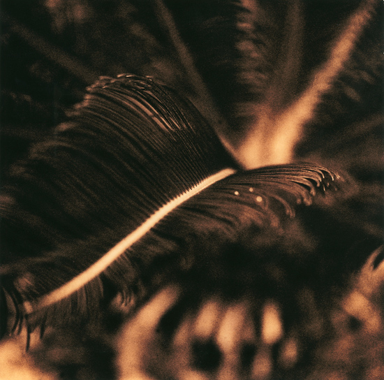

I actually cherish chocolate brown tones in lith prints even if it means that the image picks up a bit of heaviness to it. Using 1/2 very old brown + 1/2 fresh Moersch SE lith(4.5 mins) for 1st tray and omega 1+100 (1.5 mins) for 2nd tray. Finished with selenium 3 mins.
backyard
mamiya C330 180 mm
f4.5 @ 1/60
TriX 400 prescysol-ef
Fomatone classic 131 Moersch SE 5 / omega / selenium
Love the rich brown. I was playing with Foma this evening and managed to get a wonderful yellow. Seems like this paper can do all sorts of wonderful colors if you know how to bend it to your will. I've only started playing with it and hopefully I'll be able to figure it out as well as you have here.

Mark thanks, Foma in SE5/omega lith is super. Wolfgang, thanks, your chemistry is marvelous.
