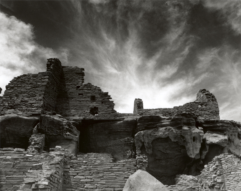

aperture: f22, shutter: 1/60, lens: Sigma 24-70 f2.8, filters: Lee #21 (orange) & .6 neutral density graduated, location: Wupatki National Monument, name: Ruins, time of day: 2:45PM 12APR06, Film: Fuji Acros 100 35mm, Printing: Paper: Ilford MGRC coldtone, exposure: 15 seconds.
While visiting Wupatki National Monument scouting for photographs, of which I have many, the sky & clouds formed this very interesting pattern right behind the main ruins, and I quickly set up and took 3 photos from slightly different positions. This is the best of those three. The clouds have an ethereal quality to them, almost like the spirits of the old ones were still there.
Wupatki National Monument, Airzona
Canon EOS-1N RS, Sigma 24-70 f2.8
f22 @ 1/60th
Fuji Acros 100, Kodak T-MAX RS
Ilford MGRC cold tone, Ilford Multigrade developer
Lee #21, .6 neutral density graduated
Nice picture. But it looks to me that the top of the "building" was burnt in while you burned in the sky.
Probably it would be better if the building was more consistant top to bottom which will unfortunately make a more difficult burn of the sky.

Nice! You caught a very dramatic sky, indeed - and I love all the shadow detail here.
Great cloud pattern.
I agree with Blansky on the tone of the structure, though the cause may be the ND grad filter rather than burning in the darkroom. This would be a good opportunity to try a contrast mask, or maybe you can get away with more localized dodging and burning.
Sometimes the effect of looking up at a building makes the building look impressive and imposing, and sometimes it just looks likes it's leaning back. In this case, I think it looks like it's leaning back. You can tilt the enlarging easel to improve that, and since the lines are curving and uneven, it probably doesn't need to be 100% corrected. If your enlarger has a tilting lens or neg stage, you can use the Scheimpflug principle to compensate for focus when tilting the easel. If not, you can stop down.
This was a straight exposure when I printed it. The effect of the sky and upper portion of the pueblo is the result of the neutral density grad filter used for this shot. Since there is still sufficient detail in the stones used to make the pueblo I will do another print and dodge out the top section of the building. I will also try tilting the enlarger head - the printing stage does not tilt.
