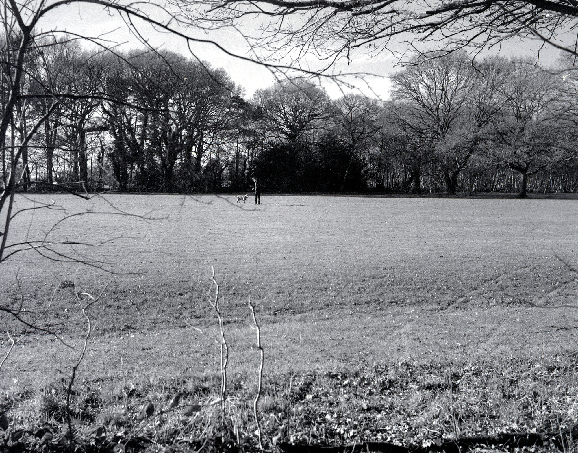

Rollei T with 510-Pro Test 03
pentaxpete
I took the 'Plunge' as I found some PYROGALLOL in depths of my Chemical Cupboard and ordered the other chemicals to make '510-Pyro' -- here I tested it with 1991 dated ORWO NP22 -- I got the 'Brown Stain'
BRENTWOOD Essex England
1956 ROLLEIFLEX T with 75mm f3.5 Zeiss TESSAR and 16-on kit
1/125 @ f8
1991 dated ORWO NP22 in home-made 510-Pyro 1:100 8 mins
Neg Scan
NONE
SCANNER : CANON 9000F Mk II + Vuescan Pro + FastStone Image Viewer
