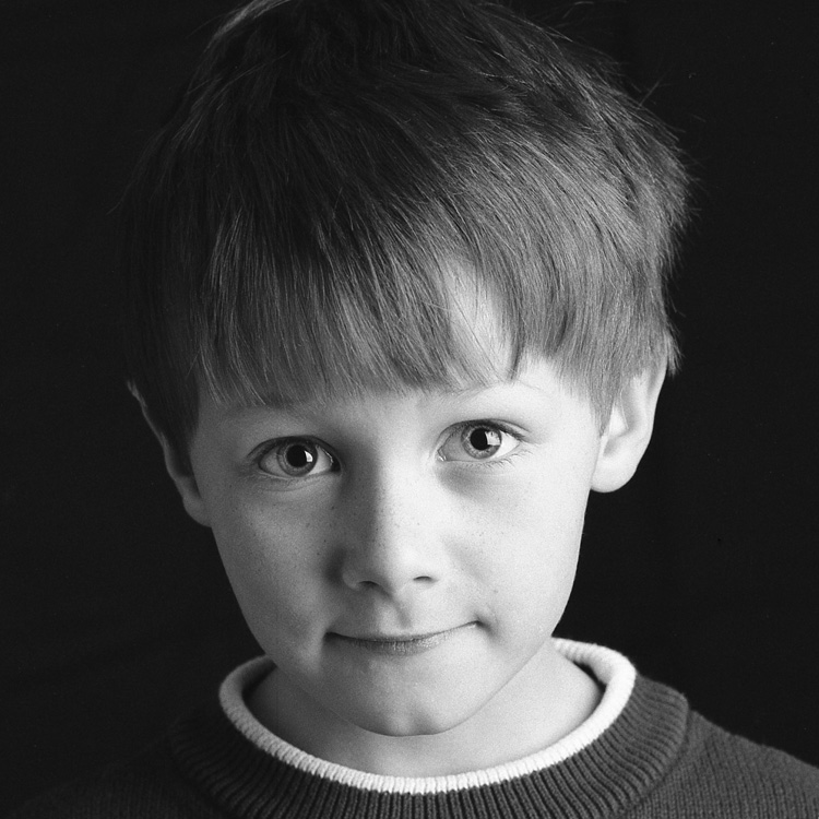

Sample: A crop (about 25 percent of 6x6 negative) showing my initial experiences with Rodinal, TXT320 versus FP4+
Bronica SQ-Ai, 180mm
1/125th, F8
Rodinal - FP4+
Negative scan
I'd say I preferred this one, but I guess that's just a personal thing. What puzzles me a bit is that you've not mentioned film speed or developer dilution/agitation, so I'm not so sure what you're intending to say here?
Good point. I posted these to go along with a thread about me trying out Rodinal for the first time but that's certainly not obvious from the gallery perspective.
The FP4+ was 1+25 for 6 minutes
The TXP320 was 1+50 for 15 minutes
Both were agitated the first 30 seconds, then for 10 seconds at the top of every minute thereafter.
I really like the look of the FP4+ as well. The 320TXP is a new film to me and I'm still getting used to it. Thanks for your input. Regards, Clifton
It appears that the Tri-X was over-exposed by about 1 stop... or maybe 1/2 stop. Did you expose it at the speed suggested by Kodak? (320 iso).
