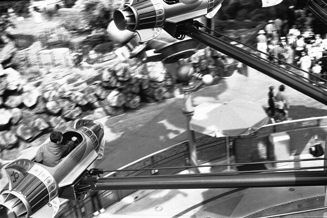

Semi Stand Pyrocat HD - Tri-x
1:1:150 36 minutes aggitation every 7 minutes
Disneyland CA
Zeiss Erconta C Tessar
250 - f8
Tri-x pcat
Love the contrast!! I just ordered some Pyrocat HD and am going to give it a try!!
Good idea on the burning in - this is a neg scan and is not manipulated - looks like my direction in the darkroom will be that burn - the stand process does make it at least N+1 maybe N+2 - tri-x at 36 minutes in 1:1:150 should support an SBR of 5 stops and gives a DR of 1.3 - PERFECT for so many scenes I do. Thanks for pointing that out.
