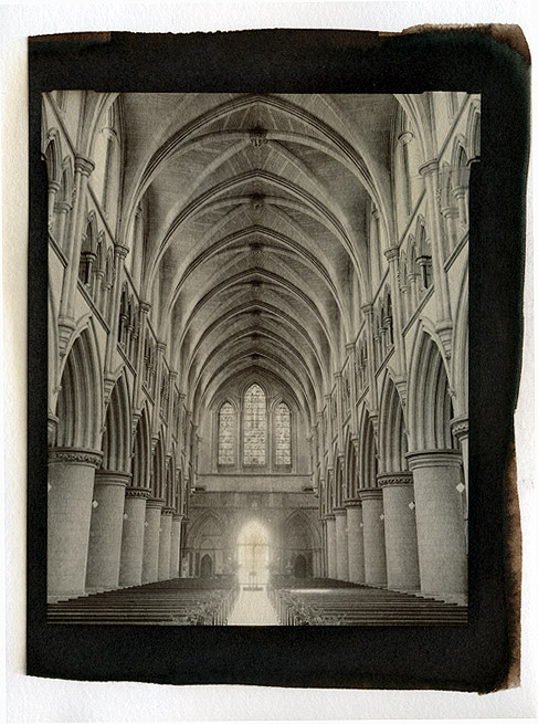

One of the six images I took last but one weekend ago. Printed using Kallitype process
Developed in Borax
Any comments regarding the 'flare' from the door.

Cambo SC 150mm
2.5 minutes @f32
FP4 in pyrocat-HD
Arches Aquarelle
I love the flare from the door, there is some slight image there sothe flare looks like it's meant to be theres. It's very spiritual. It draws you in.
The flare is there but is not as noticable in the print. There is some detail in the main highlight area(Scanner decided to ignore it). However most people I have shown say that it gives the image a spiritual feel. Light at the end of the tunnel?

Arches Aquarelle should work for Argyrotype. The only issue I have had is that it is difficult to clear residual sensistizer (Cyano and Kalli). The Kallitype issue has been solved by a citric acid(3%) presoak. Actually I just coat the area with foam brush instead of soaking. For Cyanotype I use a citric acid first wash which has helped some but not all cases.
I am going to try Arches Platine next.
