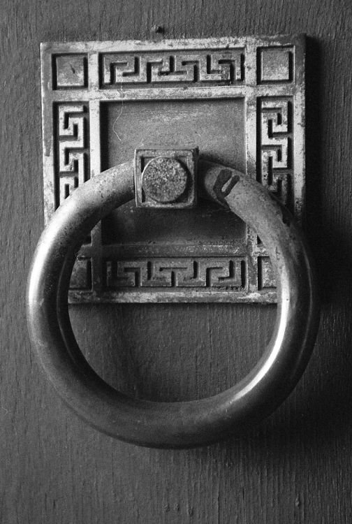

Tried to increase contrast by making a stronger dilution of pyrocat hd used 6ml A 6ml B 300ml water in paterson small tank, agitated first 30 secs, then two gentle inversions every minute. total time after pouring in dev 14 mins at 68f Ilford delta 400 at 200. I think it looks ok what do you think?
crich stand derbyshire uk
nikon fm3a
cant remember
delta 400 pyrocat hd
neg scan as is
green
Yes Flying camera I agree the proof of the pudding will be in the print, Now that I have put my glasses on I have noticed the scan has a little squiggle of fluff on it, did not use the dust removal or ice option, ah! well . Also I did not use a tripod as I was on my motorcycle. I am tempted to print this 35mm neg and then go back and retake the shot with a med format camera.
