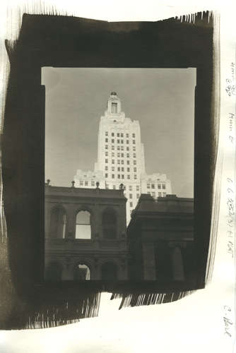

One of the best preserved and un yuppied areas I've seen. Done on Cranes Pearl with 1 drop of Plat. along with the NA2 process
Providence RI
5x7 Deardorf
f/32@i/10 sec
TMY400+D-76
Cranes Pearl
12f
