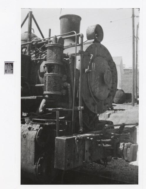

A frame from my Minox B, taken on Delta 100 film from Blue Moon, here printed with a Mamiya ENLA head. The head is designed for a slightly larger frame, but did OK. I cut some pieces to mount the head and set it up. I could not get my MicroSight to show me any grain -- need to dig into that further.
The ENLA head replaces a normal enlarger lens and contains a condenser, focusing mount and negative carrier. It uses the host enlarger as a light source and mounting bracket. The small frame on the left is the actual 8x11mm negative, this nearly 5x7 print is about a 16x enlargement. Doubt it will happen often, but it wasn't totally terrible!
A fine specimen to use it on - or most any other platform. 'Sounds like a labor of love to print that way. Thx for posting.
