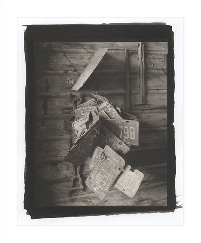

plates,2007
michael9793
plates,2007
same as others
Myakka City
8x10 Ebony with a 300mm ektar lens
5 mins f/16
Efke 100, pyrocat HD
plantinotype,FeO-18drops,Pt/Pd-9/9,na2-0, am. oxilate
none
Jan
all the prints were 6-8 mins. I thought it would have been more. but I am in Florida so the UV is highter here than other part of the country.
Mike Andersen
Michael, looks good from where I am sitting. Would say that six years away from plt/pld have not hurt at all and the sun exposures look to be working very well. Have been following your questions in the forums and it is good to see the resulting work. Thanks for sharing.
Love this, Michael. Wonderful.
- Thomas
Thanks everyone for the nice words.
Jan, that may have been something to think about, but in the summer we get a lot of clouds during the day and sometimes I can only print after work at night. so the UV box is a nice thing to have so you don't have to depend on the sun all the time. I read in EW's datebooks how he would have to go periods of time not printing do to the sun and clouds. but it is fun using mother nature for your light source.
mike
