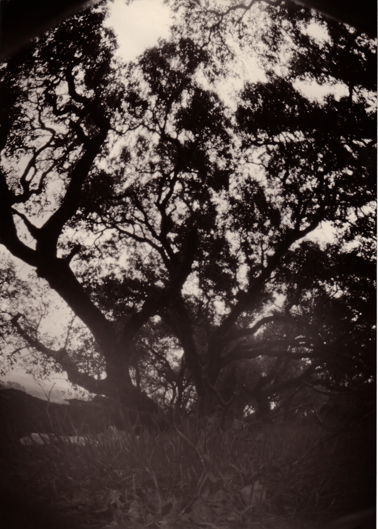

Direct paper positive using weak 3% hydrogen peroxide with a little citric acid as bleach. This is a process that Ricardo Leite used to make film reversal and Joe VanCleave successfully used to reverse paper negatives, but with weaker H2O2. Re-developed with thiourea, skipping re-exposure.
Taylor Mountain, Sonoma County, California
coffee can pinhole camera
1 hour in light rain
n/a
Adorama VCRC, LPD, bleach, re-develop in thiourea
just air all the way from the trees to the paper, no lens
Hybrid Materials & Processing
Not hybrid
Scanned and adjust levels to try to match what the print looks like in hand.
Ned Lewis
I like the juxtaposition of the somewhat mundane grass foreground and the dramatic oak. Also the process sounds just about esoteric enough to give it a try.
