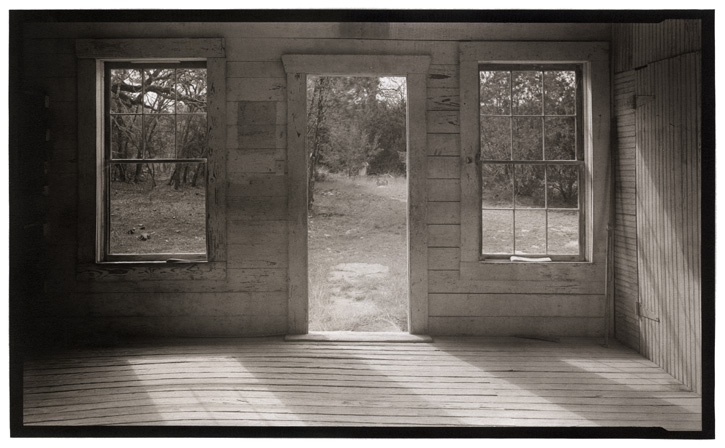

Peyton Colony - Old Schoolhouse
Another recent pt/pd print.
Peyton Colony, TX
12x20 Folmer & Schwing, 355mm G Claron
25secs @ F64
Efke PL100 PyroHD
Pt/Pd Print on Rives BFK dev in PotOx
I'm amazed by the tonal range here. Talk about setting the bar high...
Thanks all. I shot these last Sunday. Got around to printing them yesterday.
very nice luminous prints ... really nice composition also .... do you have to do anything special with Rives paper efore you coat ?
Thank you again all. Greatly appreciate the kind words.
Miles, in regards to rives BFK (and this is per Clay Harmon's advice and some stumbling on my own) I steam the paper a bit before coating to get the humidity up.
I also add about 25% of the total coating volume in distilled water. For example if your coating solution was 10 drops of Ferric Ox and 10 drops of Palladium (total of 20 drops) I would add an additional 5 drops of distilled water to that amount. Helps with the absorbancy of Rives BFK.
After coating, I let it sit for a few mins and then hit it with a hair dryer on the back of the paper. to help speed the drying so it doesnt absorb into the paper too much.
Then I resteam it some to rehumidify it and then print and process normally.
