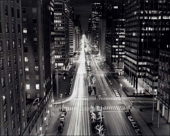

Taken a few years ago, but I just realized my fondness for vanishing point perspective vs a vis my most recent work. curious.
Park Avenue from the NY Central RR Landmark Bldg.
Pentax 67, 55mm lens
45 seconds or therabouts as I recall.
Delta 100 in ID11
Ilford MGIV in Ilford Paper Developer
yup! i bracketed as though there would be no tomorrow, which from this site was true. my spotmeter was useless in this light so i just made all 10 exposures with my best guesstimate from previous nighttime photography in the city. (i normally never bracket, but this was a one time only opportunity to photograph at this location, so i didn't hesitate.)

This view is from the 10th story office of a close friend who ceased working there shortly thereafter. It was as close to the center of the building as I could have ever hoped for it to be. The photograph was made at about 5:30 PM on Christmas eve, 2000.
Never, never put off making a photograph with the excuse that you'll come back later. This opportunity came only this once and I didn't come back to make a daylight image.

I'm especially impressed by the results you obtained from a "normal" developer. Do you remember the time and/or agitation; specifically, did you use minus development?
Konical
Thank you, folks for your comments.
Konical: No, no minus development employed. When bracketing, my approach is to use normal time, temperature and chemicals...one of them suckers is gonna work..betcha! Seriously though, I was quite sure I'd get a good result with customary procedure given the lattitude in exposure I'd made use of. The print of this did require some manipulations (chiefly, some burning in of overbright sections of a building on the left and some dodging of several buildings on the right and top of the image.), but was generally not too difficult to print. Thanks for asking.
