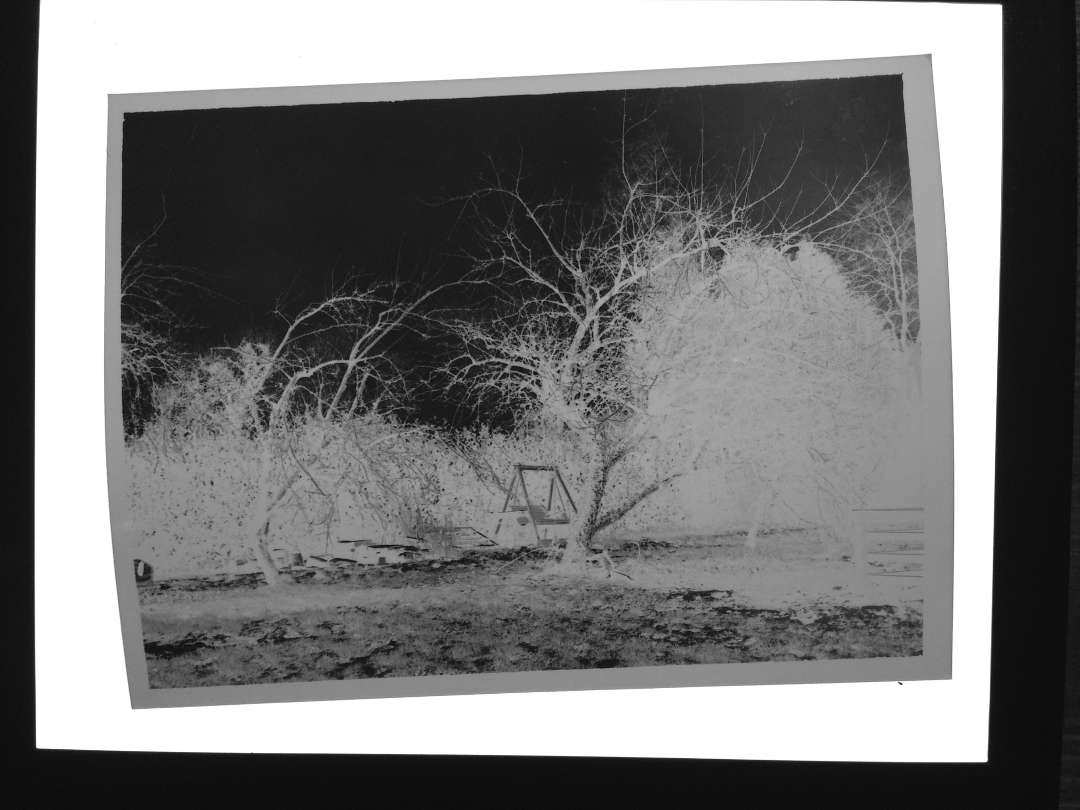

Several years ago I used to shoot paper negatives a lot. Just recently, after moving house, I found one of my ET Underwood 'Instanto' cameras from c1896, cut some paper down, guessed the exposure and developed it in Rodinal. Paper neg shown on the light box.
In my orchard, Somerset (UK)
ET Underwood 'Instanto' quarter-plate camera.
6 seconds at f32
Ilford MG RC in Rodinal 1+20

I took two shots - one at 3 seconds, the other (this one) at 6 seconds. There's detail in the shadows of the trees, which I was surprised with. The image itself was just a random shot, nothing special!
@Andrew O'Neill - Back when I did a reasonable amount of paper negatives (even taking the 1/4-plate camera up the French Alps!) I used a yellow filter with it. Do you use a filter? I've not tried pre-flashing the paper and this is the first time that I've had a go with using Rodinal to develop paper. Which developer do you use?
I would say it went very well, Dee. A lot of good detail in all parts of the neg. Man, I have some catching up to do.
