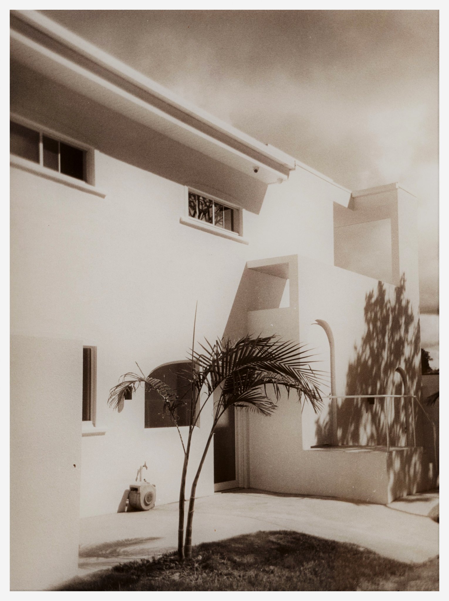

Darkroom print, used red filter and then print was toned with selenium then bleach a moment to get the highlights to glow.
Suburbia
Holga 120
N
HP5 in d76
Ilford rc grade 2
Red.

Scan and tidy up.
Nice! I'll have to figure out how to put filters on my Holga. And adjust the exposure!
Masterful, especially considering you used a Holga. beautiful, careful, composition. The warm print tones are very pleasing. I wonder what bleach you used.
Doug
@mike c @mfohl @artonpaper Thanks, I liked the architecture and seemed to would work well with a red filter. I just use 52mm filters and hold them on, must be carefull not to get fingers in the way, plenty of bright light here in sunny f22 land. Potassium Ferricyanide & Potassium Bromide, standard sepia toned bleach. Selenium holds the dark bits and just need to wash the bleach before loosing the highlights, can redevelop if you go too far.
