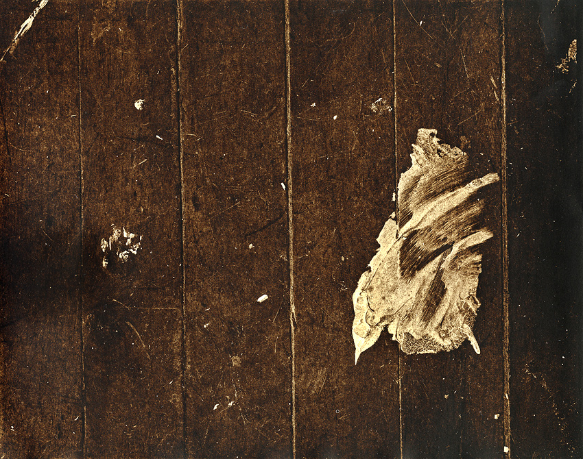

I tried lith printing for the first time a few days ago. This negative is what spurred me to get my hands on the materials.
Blanahasset Island, Marshall, NC
Wehman 8x10, Fujinon W 300mm f/5.6
3m15s @ f/45 2/3
Efke PL 100, Pyrocat- HD 1:1:100 for 8min
Forte Polywarmtone, Aristo Lith Dev
I think this was an excellent choice for the process and that this turned out great.
That big 8x10 neg makes this image virtually 3D from here.
Just great! Wonderful details in it.
- Have you cleaned the bird after using? :wink:
The silver version just didn't look right to me.. What I saw originally was a very dark floor, and the white paint standing out. I couldn't do anything to get the floor dark enough using my usual process, and I had read something about the contrast abilities of lith- so I just had to try it. I want to gold tone this one, but haven't found a kit that wasn't to expensive for my intended use. Maybe if I mix my own it will be cheaper?
This is very cool. I love this kind of vision.
great shot, the whole idea works very well. you have a very good eye for fine art photography. keep more coming......frank
