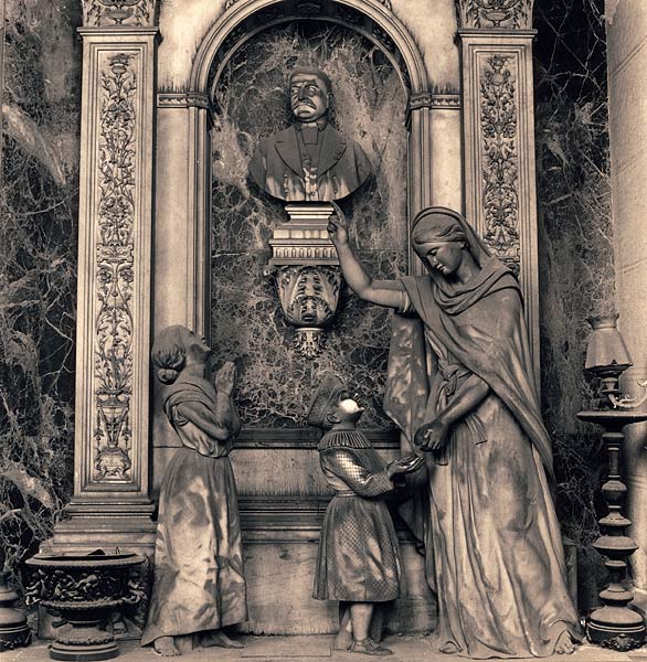

The Ilford MG IV shows a wide (reproducible) colour range with redevelopment in lith and is therefore been suitable well for the entry into the technology.
Influence on tone and gradation has the degree of overexposure of the print, the acidity of the bleach and the dilution and temperature of the lith-developer.
For this paper, a dilution of 1+25 (SE5 LITH) has proven to be optimal. With temperatures between 25-30°C, the redevelopment is completed after four to five minutes. The print should appear something too gloomily then, lights and mids are brightened up by the fixer.
Bleach. copper/hydrochloric acid
Cimitero Staglieno, Genova
Hasselblad
Ilford MGIV redev. SE5 Lith

In most cases, I use the following recipe:
Copper bleach:
Copper sulphate 100g
Sodium chloride 100g
Sulphuric acid 40-80ml
to make one litre stock
working solution: full strange up to 1+5
in any case bleach until all silver vanishes
I sell this bleach with an amount of 40ml acid, but with some papers a higher amount would be better to achieve clean bright (instead yellow) whites. On the other hand, the control becomes more difficult then with redevelopment. If the obtaining of copper sulphate and acid is no problem, you should mix yourself a special bleach for each paper.
In general: more acid = brighter base, faster and less controllable developing and more bluish colour.
