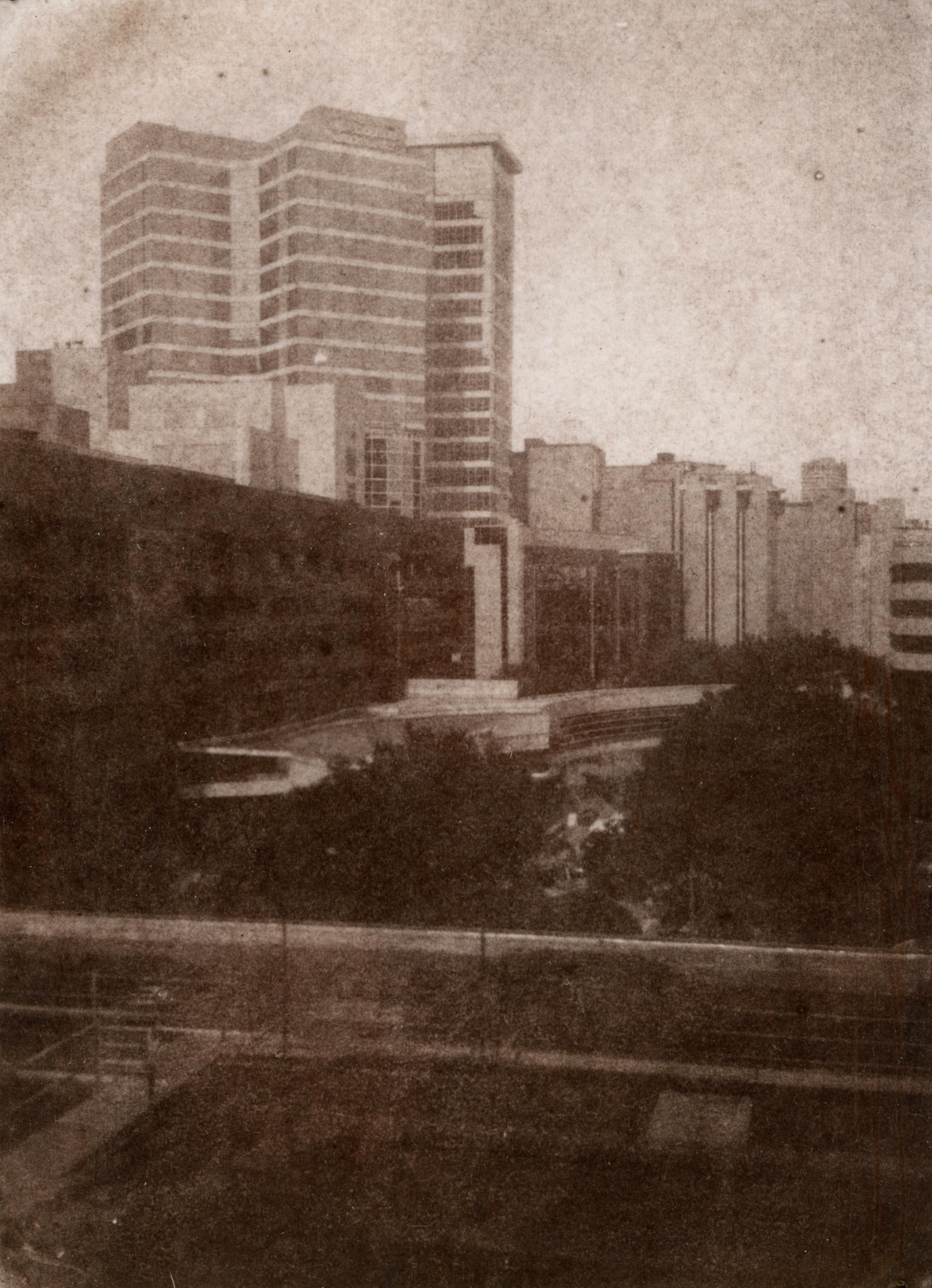

This image marks my first successful calotype to salt print. Granted still needs some work to get the exposure down, but nonetheless I am quite proud of this. If anyone has some tips or tricks I'd love to know!
Texas Medical Center
Ihagee 9x12
4 minutes
Calotype on Canson Marker paper and gallo-aceto-silver solution
Fabriano Bristol and citric acid
None
Hybrid Materials & Processing
None besides scanning, no post processing done.

Well done, it looks good to me.
I've been making salt prints for the past 15-odd years but have never started in the right place - i.e. calotypes. I should have a try, thanks for giving me a push.
And keep on with your own project, you have a really good starting point.
Calotypes are a fun process honestly. The most important things I've noted is the use of CLEAN water, acidifying the paper makes a huge difference, washing any of the containers you'll use, and not touching the paper after sensitization with your bare hands. That last part ruined what would have been a lovely photo for me. One thing I also noticed is that acid fixers seem to give cleaner negatives but I haven't gotten the chance to properly test that out. My theory is the acidity would help remove any residual bromine/iodine salts preventing unwanted browning of the paper.
