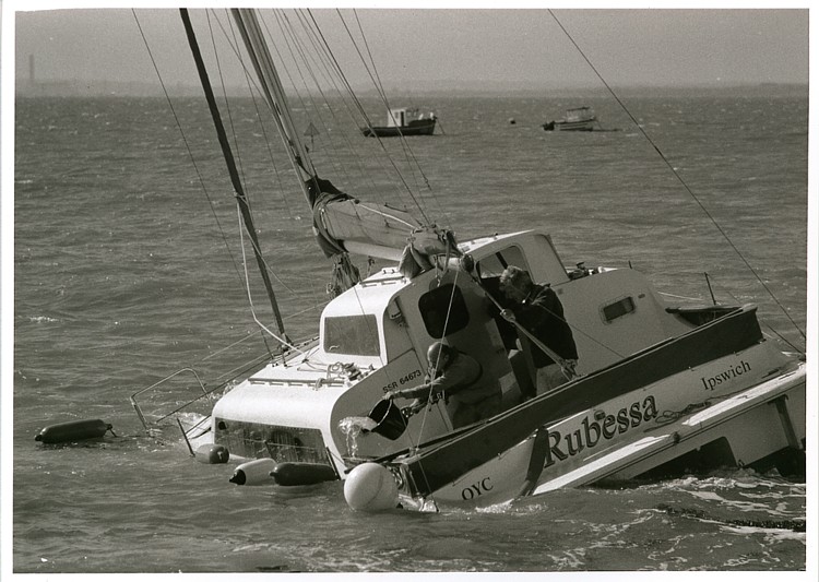

Strange. Having made the print it seems almost sepia toned compared to the negative scan. I have noticed this in other prints but not as strongly as this one. Paper used was Ilford MGIVRC DeLuxe Pearl 6.5" x 8.5". Developer was Ilford Multigrade diluted at 1+9, fixer was Ilford Rapid Fix diluted at 1+4. Print was rinsed under running water for five minutes. Any suggestions as to reasons behind the tone of the print would be useful. Thanks folks!
Ps. This is just a working print, hence the diagonal on the top left corner. If I get time I'll have another go at it tonight.

Voigtlander Bessaflex, Helios 1:2.8 135mm lens.
1/1000 @ f5.6
Ilford FP4+ in Rodinal 1+50
Ilford MGIV RC DeLuxe in Ilford Multigrade 1+9
Grade 2
Only thing that occurs is that I seem to recall reading that old developer, reaching exhaustion can give a warm tone effect (bromide buildup in the developer?).

That could be the answer thanks Bob. The dev used was made two weeks ago.

Andy, it's certainly more sepia than the same shot on the other site. I presume the other was a neg scan. I like the look personally. The water 's look gives it a real presence as if it's about to wash over the bottom margin.
