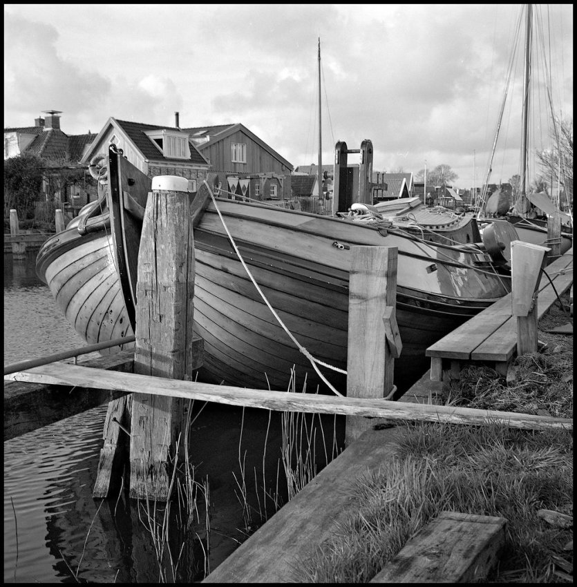

Old sailing vessel
macfred
Old sailing vessel
captured while strolling the harbour
Warkum, Fiesland / The Netherlands
Rolleiflex 3.5F - Planar
not recorded
FUJI Neopan 400CN - Caffenol CL using the semi-stand technique for 65 minutes @ 21 degrees Celcius
Rolleo yellow
I find this series of images you have put up to be excellent in tone range. No highlight clipping and near perfect shadow detail. Do you find that Caffenol CL to render images just as good as those processed in C41 developer? I do all my B&W film developing, but haven't tried home development of C41. I'd rather not do C41 at home if something like Caffenol CL works just as well. Your photos sure look nice to me. JohnW
John, thank you for your kind comment !
The results with Caffenol CL are not better or worse than in C-41 - I found the recipe here in the forum and I wanted to give it a try. It was now my third roll with Caffenol CL and I am quite satisfied. Tone range is always nice with the chromogenic films.
That's good to know and I'd be very happy with results equal to yours. I'll have to use XP2 since I have no Fuji 400CN. I have tried caffenol one time with FP4+ and HP5+, but ended up sticking with Xtol-R. C41 B&W is a whole different ballgame and your Caffenol stand developement seems to be a very good match for the style images I do. Nice work and that old 3.5F just keeps popping them out. JohnW
