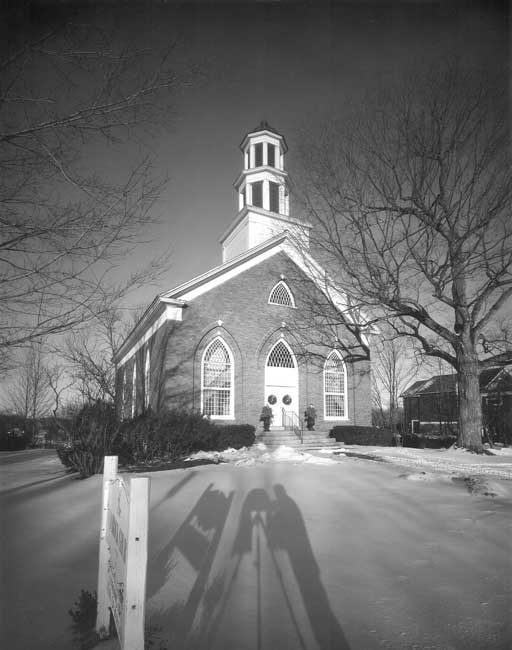

This is the first image I made with this lens. I used it in barrel with a black 35mm film canister cap as the lens cap/shutter. I had it mounted on my Kodak Master and gave it as much front rise as I dared - stopped all the way down - The photo was taken on December 22 at about 2:30pm - the day after the Winter Solstice.
Williston, VT
8x10 - 6 1/2x8 1/2 Protar V
~1 sec at f/64
J&C 100 - HC-110 - DBI
AZO - Dektol
I really like this photo !!!
I'm curious though - do you remember if you were using any front rise? Or was it all tripod pitch?
